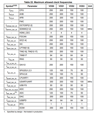

For H7, the kernel clock limit are given in Table 61 Kernel clock distribution overview as shown in
https://community.st.com/t5/stm32cubemx-mcus/stm32h745-fdcan-clock-frequency/td-p/83540
I do not find a similar table for U5 in the most recent datasheets and reference manual. If I did not look carefully enough, any hint to find it is welcome. Otherwise ST should  consider adding like for H7.

In fact the same table is provided for STM32H5 product in the datasheet:
