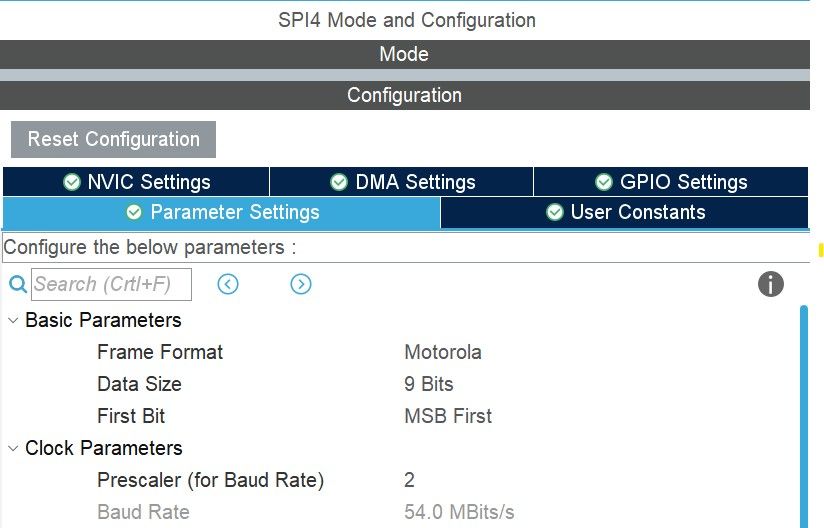

I'm currently using a stm32f767 board and I'm going to try lcd this time.
I need to use spi 9bit to write my lcd, but I set the data size to 9bit in the settings window.

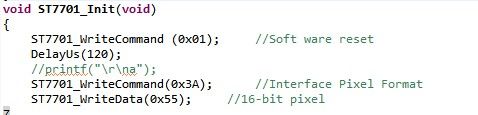

I want to implement it as ST7701.
Below is the mode and code I set.
Please check if there is no problem.

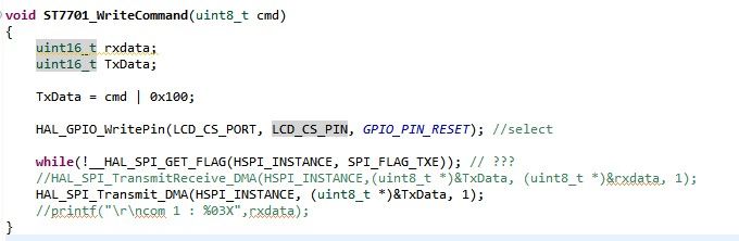

​Send D/C bits to the first bit together.
I set it up like this.
0693W000007E2V7QAK.jpgRESET CS pins, 8-bit data, TxData = cmd | 0x100 and send to HAL_SPI_Transmit_DMA.

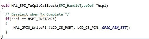

​CS pin SET check is done like this.
​Is this the right way to do a 9-bit transmission?

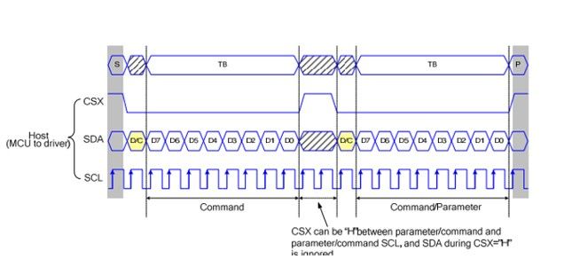

And what do you see on the SPI pins?
