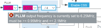

My clock configuration should be (I believe I have set it so) exactly depicted in this picture:
However, I am still getting unreasonable time intervals:
Any ideas?

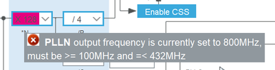

So 750us per 100 ticks with a x100 prescaler, suggests the timer clock is ~13.3 MHz.
Given the errors in your clock setup (red boxes), I'm guessing the system clock fails to switch over to HSE-based PLL and you are still using the HSI (16 MHz) for the clock, which is roughly in-line with what you're seeing.
Double check clock settings, verify HSE=25 MHz, correct errors.
Check return values from HAL_* clock setup functions.
Hovering over errors (red boxes) in STM32CubeMX will tell you the cause of the error. In this case:
And:
Adjust PLLM/PLLN/PLLP to satisfy this requirement as well as your target clock speed.

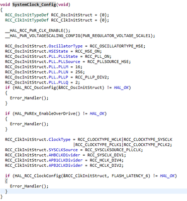

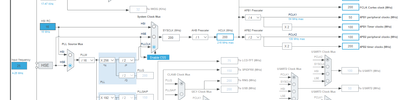

 At this clock setup:
However, I only get 100 us delay when using 49 timer prescaler. If I use the 99 for supposed 100 MHz timer clock, I get 200 us of delay. Should this be like that and the timer clock is derived from the basic APB1 clock (the slower peripheral version of APB1) Or I missed some clock configuration setting once again?
I might be too picky on this one, but is 101.something us delay can be justified? Considering a 200 MHz core clock and absolute minimal overhead that 1.3 us of error seems like quite too much for it... Do I just take it for granted or there is something I am doing wrong yet again and I have to fix it? Thank you once again, this conversation is helping me a lot.
Probably there is an error in your clock settings. Consider setting it up in CubeMX and checking your RCC register values against there. There's probably a prescaler you're setting to 1 that actually means 2 or something.
Your timer precision is 1 us, so +/- 1 us of jitter should be expected. (and actually this is +/- 2 us due to the error above). If you want better resolution, use a 32-bit timer with no prescaler and adjust things accordingly. For example, use PSC=0 and change your function:

This is what CubeMX generates based on these clock settings:
After profound investigation, everything looks just the same that I write to registers (double checked all the macro prescaler values.)

Really wonder why is my timer still at 50 Mhz clock... This is a crucial point in further code and timers development. Not asking to do the debugging for me, but are there any other potential hooks causing this problem?
Not really. There is the TIMPRE bit, but that's unlikely to have been changed from default.
Don't look at the code--at least not for right now--look at the values within the relevant RCC registers after running your code vs after running CubeMX code. It takes maybe 5 minutes to do this and it will provide the answer, provided something is in fact different.
