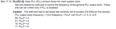

I am at the beginning of my STM32F756VGH6 register programming journey. I have already setup everything, and now I am at the led blink (using a logic analyzer for measuring the time intervals). I decided to make a simple blocking delay function out of a basic timer. The reference manual of STM32F756VGH6 describes the basic timers as really simple and beginner friendly peripheral. I did my best to follow the datasheet and common sense. However, the timer is completely unpredictable right now... Increasing or decreasing the counter prescaler results in some 1.5x or 2.3x incremental steps (prescalers can only by round numbers.) I am not sure is my timer 6 primarily fed with 50 MHz or 100 MHz, because APB1 clock have 2 derivatives, one dedicated only to timer peripherals, so I was going out to find it out by experimenting with the delay value. However, giving the delay function variable of only "1" results in some 6.167 us delay, which is orders of magnitude more than it should be considering even a 50 Mhz clock with the prescaler of 1. Increasing the delay function argument does not make the delay longer proportionally to the increase... I can not find a relation between function variable and the real timer speed. I guess its a beginners mistake and I simply missed something, but at this point I need some help. Thank you in advance. (Code comments explain my core clock setup):

Seems like TIMPRE bit saved me this time... I still dont get the logic behind it, here is a datasheet description:

I only get the right time intervals when I set the TIMPRE to 1, on the other hand, I am still using this exact clock setup:
But in the code (the delay function) I treat my timer clock as 100 MHz one. If TIMxCLK = 4xPCLKx like the datasheet tells, the timer clock should be 50Mhz x4 which is beyond the APB1 timer clock capabilities... Guess I am really missing out something...

‎2024-01-16 9:18 AM
Clock is indeed 200 MHZ. Turned out to be a dodgy STM32 Macro...
Good old bitwise operations like:
RCC->PLLCFGR &= ~(1 << 16);
RCC->PLLCFGR &= ~(1 << 17);
finally did it. Now I can sleep in peace :)

‎2024-01-17 11:29 AM
The one that I used to set PLL P divider
