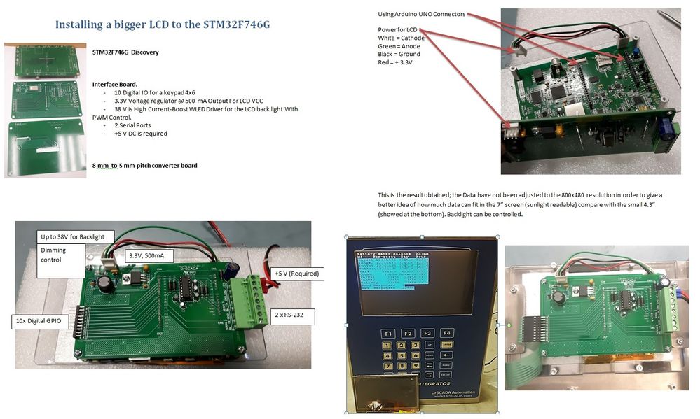

Posted on January 16, 2017 at 18:53
I bought a STM32F746G-DISCO board and have decided that a board like it will fit the needs of my project. Are there any companies that make development boards with this MCU that can use a larger LCD display? The disco board has a 40 pin RGB interface with the touch pins combined within the 40 pins and I can't seem to find a larger LCD panel that has this connector. Do any companies make other boards for this MCU?

Posted on May 30, 2017 at 23:21
This is How we solved the issue of having a small 4.3'' and also non sunlight readable LCD.0690X00000603rCQAQ.jpg
