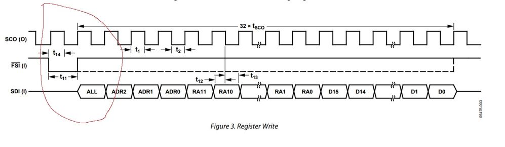

‎2021-12-20 9:49 AM
Thanks a lot, it seems that no problem to do so. The second question is with this diagramFSI is output for stm, and it's not NSS at all. How to connect second falling clock edge with gpio?
