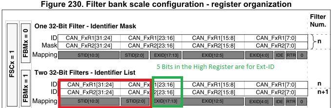

JSzuc
Hi Szymon!
I try the example on an stm32f103c8t6 and its working fine, but I cant change the filter config to "_IDLIST", Its simply not work anymore in any combination of the mask and id… May be I missed something...
Regards.
J.

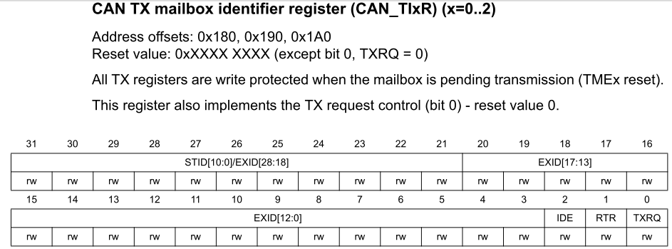

Hi szja681.5541402147734006E12,
I began recently with Microcontroller and STM32 and I stumbled over the same issue.
If you are using a standard-ID ( CAN_TxHeaderTypeDef TxHeader; TxHeader.IDE = CAN_ID_STD;)
and Filterscale 32Bit (sFilterConfig.FilterScale = CAN_FILTERSCALE_32BIT;)
you have to shift FilterIDHigh and FilterMaskIdHigh by 5 Bits to the left.
E.g.
sFilterConfig.FilterIdHigh = 0x0123<<5;
sFilterConfig.FilterMaskIdHigh = 0x0123<<5;
This is IMO due to the register in the Tx Mailbox.
Here is picture from the STM32F103 Reference Manual .
As you can see the Std-Id is from [31:21].
If you don't shift the Filter ID the comparison will fail.
Because the STD-ID is left justified in the comparing Mailbox.
Here is a pic from the register Organisation.
Mapping is your Mailbox register.0690X000009YEoEQAW.pngI hope this will help someone.
Pictures are taken from the reference manual and are not my property.
Greetings
Rene
