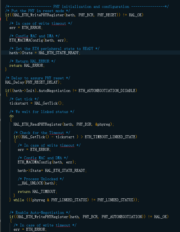

My hardware is F429 + LAN8720A, firmware is STM32Cube_FW_F4_V1.16.0
when power up, everything is ok,  PHY_BCR = 0x3100, phy link up, at this time I just reset f429,
PHY_B
C
R = 0x2100, PHY link failed, and the two leds are off.Here are some codes in the HAL driver:
My question is after reset we should set the BCR, but the HAL driver reset the BCR, then just wait link up, is that right?

    F429 reset pin and LAN8720A  reset pin use the same reset signal. I use the HAL_NVIC_SystemReset() to soft reset F429.
    Now I add HAL_ETH_WritePHYRegister(heth, PHY_BCR, PHY_AUTONEGOTIATION) after  HAL_Delay(PHY_RESET_DELAY);
