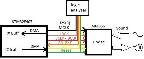

I’m having a problem with my project.
The project is just a simple sound “loop�?
It is a stm32f4discovery connected to a audio codec. They communicate over I2S3 in Full Duplex mode and the stm32f4 uses DMA to handle data.
My problem is this: I’m able to send data out, but not receive any my Rx buffer is written to zero all the time.

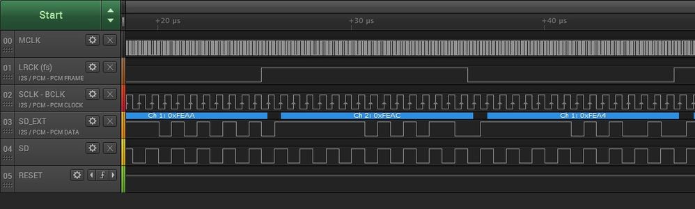

So I can see my data is on the SD_EXT line, but I’m just not able to get it inside the stm32f4.

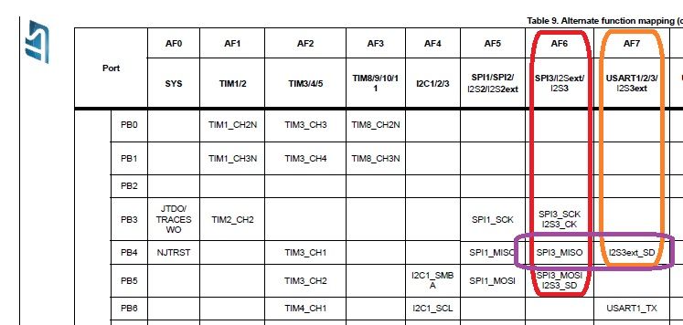

Posted on January 28, 2015 at 15:10
Unfortunately half the defines are missing.
Double check the AF pin settings in the Data Sheet, they might not all be classified as SPI3

I'm pretty sure i checked that the pins had I2S3 as AF.
Posted on January 28, 2015 at 17:12
No, what Alternate Function is used by the pin. There's a trap for the unwary, and you've fallen in it.
rasmus
Posted on January 30, 2015 at 08:29
Yep, you were right, I missed that.
Now it's working like a charm.
Thank you very much for your help, much appreciated.
