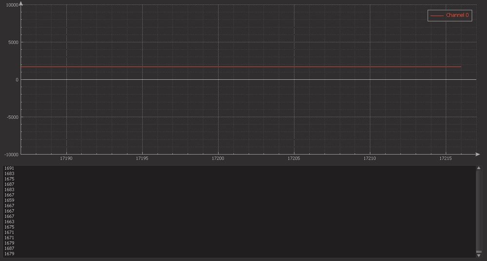

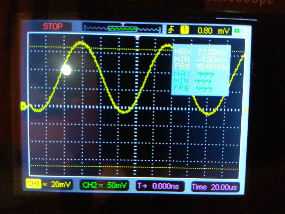

What is the observed behaviour? What are the waveforms on the SPI pins of the ADS8885? Do they match the description in the ADS8885 datasheet?
MDoln.1
Hi
Manage it strangely when I connect pin 4 of AINN to GND so it works it doesn't work only in True-Differential when I use both AINP and AINN inputs.
MDoln.1
Hi

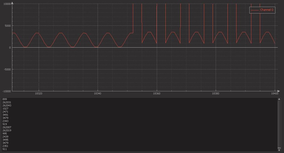

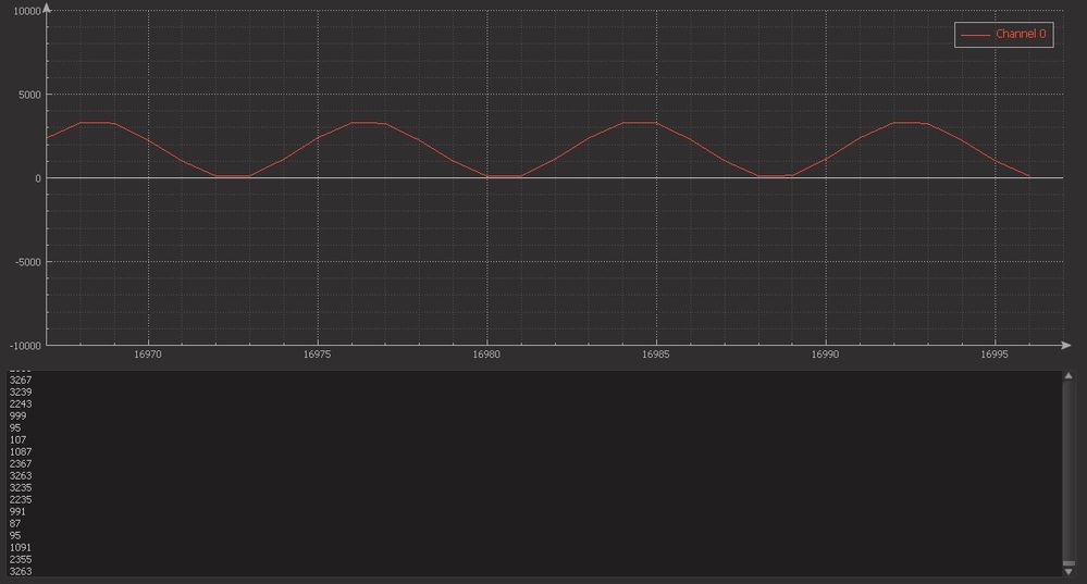

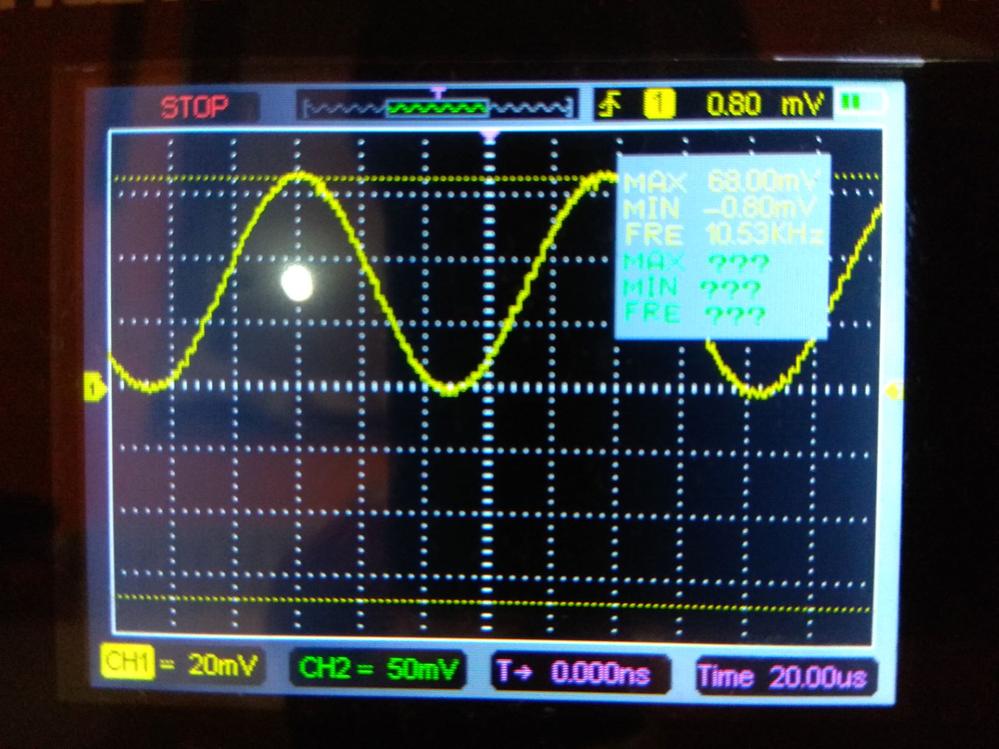

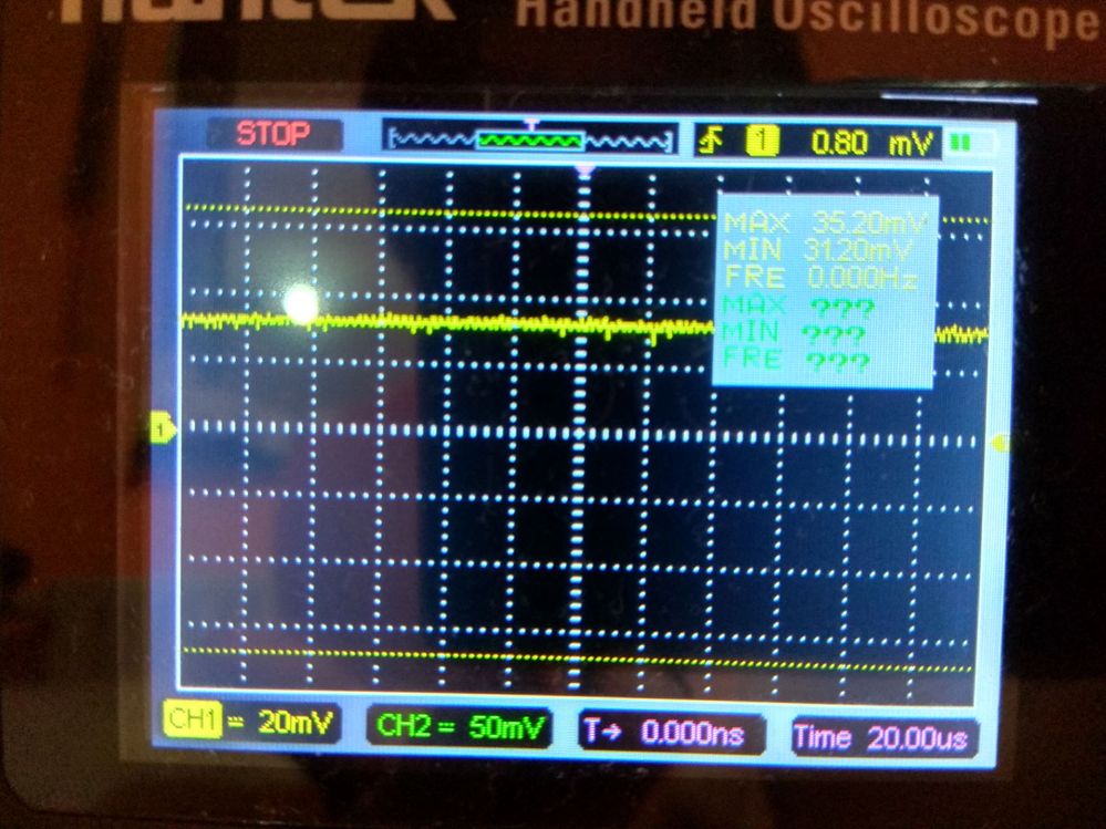

I'm adding a few photos that show my problem with ADC in the first two photos is ADC without the input signal on the other two is the signal OK until it exceeds a certain value and then the output data will start to deform as seen in the last two photos. The signal displayed on the Oscilloscope is measured on 3.4 ADC pins.
0690X00000BwlrRQAR.jpg0690X00000BwlrbQAB.jpg0690X00000BwlrlQAB.jpg0690X00000BwlrqQAB.jpg0690X00000BwlrvQAB.jpg0690X00000Bwls0QAB.jpg
waclawek.jan
Looks like signed values interpreted as unsigned.
