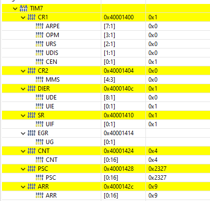

In parallel, I'm using the timer7 (triggered every 1ms).
It works well.
But, yesterday, I've added some cases, and when my software run into them, I see the tim7 stops (I've put a GPIO in the interrupt and a probe on it).
So, I see that before entering in the HAL_UART_Transmit_DMA function, it works and after it stops.
When I take a look on tim7 registers, everything seems to be OK, except UIF that keeps at 1 (so the interrupt is never resetted).
If you have some ideas, I'll be very happy.

TIM7 isn't stopping, the interrupt is just not being serviced.
If UIF=1 the interrupt will be called when the CPU gets time.
If the interrupt is never called, another interrupt is being processed. Since it happens after HAL_UART_Transmit_DMA, probably due to this. Possibly a UART error is happening and isn't being cleared.
Debug the code, hit pause, see where execution is at.
