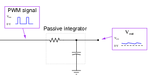

Hi. What I mean is the voltage across the pwm pin and ground pin is not varying in proportion to the changes I make in the values of the arr and ccr registers. For example, the if arr = 500 and ccr = 100, then the output voltage is almost the same as when arr = 500 and ccr = 200. According to the user manual I should get duty cycles of 100/500 * 100 and 200/500 * 100 ( In percentages).
‎2017-08-09 6:25 PM
Hi !
But PWM is pulse width modulation , digital pulses.
In case you use an intergator after output(resistor-capacitor) you must have in mind the internal resistance of the GPIO output. (to add to your, in series resistor, and to calculate after the capacitor)
Just remember that the Delta voltage of the capacitor charged by a const voltage via a resistor, is
not proportional
to width of pulse .So If you want to convert PWM to voltage, choose the resistance of intergrator to be multiple of intternal resistance to have a good dynamic range, and of course a small (nF scale) capacitor , to observe to an oscilloscope.
Arr changes the frequency ( cycle period) and CCR the duty cycle (0-100%)
