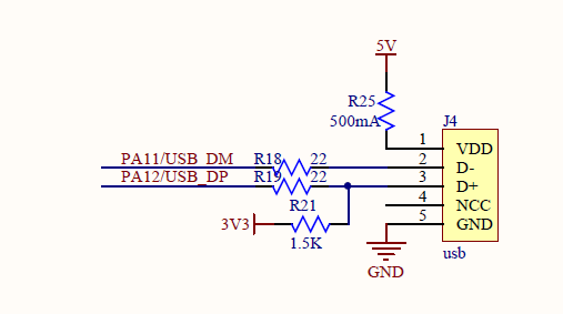

I am testing out the USB HID (otg fs) feature of my board with stm32f407vet6 mcu. I used stm32cubemx to configure it and i didn't add anything to the while loop in main c, just seeing if the device can be detected or not. However, after I uploaded  the code  and resetted the board, no response was given and I could not find any relevant port in the device manager of my pc.  The attached are the schematic for the usb_slave port and configuration in stm32cubemx.

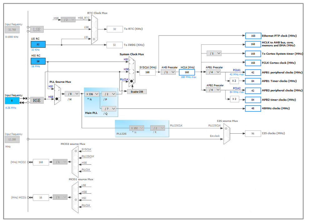

Can you show us your clock configuration? Clock is in most cases main problem why USB does not work.

This is my clocking configuration; the clocking for usb is 48Mhz I think.0690X00000607wgQAA.png

The problem is solved. It turns out that in the schematic I pulled up the PA12(D+) pin to make the host device recognize the board as a full speed device. However, it is not necessary and is wrong. I only need to connect PA12 directly to the D+ in usb connector and it works fine.
