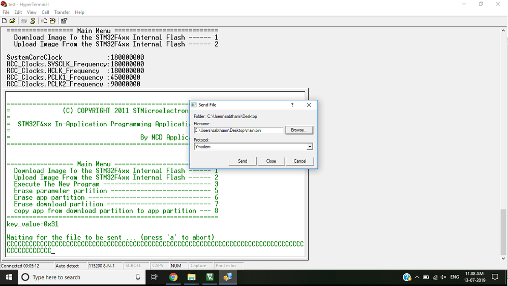

Hai, I am using stm32f429igt controller I am trying to use IAP and found one example with stm32f4 cube package. While trying the example the code is not getting uploaded when I tried to upload it still waiting for the file can anyone help me how to solve this.

You need to use Y-Modem to send a binary file, not send a string of hex codes.
‎2019-07-12 9:20 PM
Ya I am using Y-Modem to receive the binary file which i generated from the keil IDE. When it waiting for the file I am sending the file using Hercules terminal after it is send it still waiting for the file if i send it twice it goes into hard fault handler. Is that anything else i have to add to the binary file generated to end the transmission...?? (i.e) the file is successfully received.

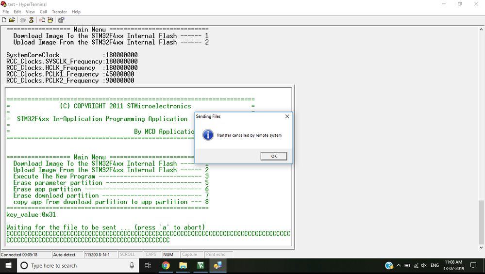

‎2019-07-12 10:46 PM
Hi i just now figured out what you said that i have send the binary file using Y-Modem protocol. Now i have used hyper terminal to send the file using Y-Modem protocol but in his also i am getting some error when sending the file below i have attached the screen short of my error.
