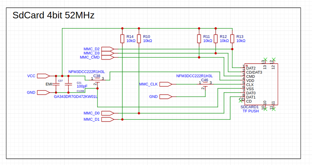

A schematic of the card might work better and a picture in expressing the circuit.

This is the schematic of the SD card test board, and it works fine with Espressif.
