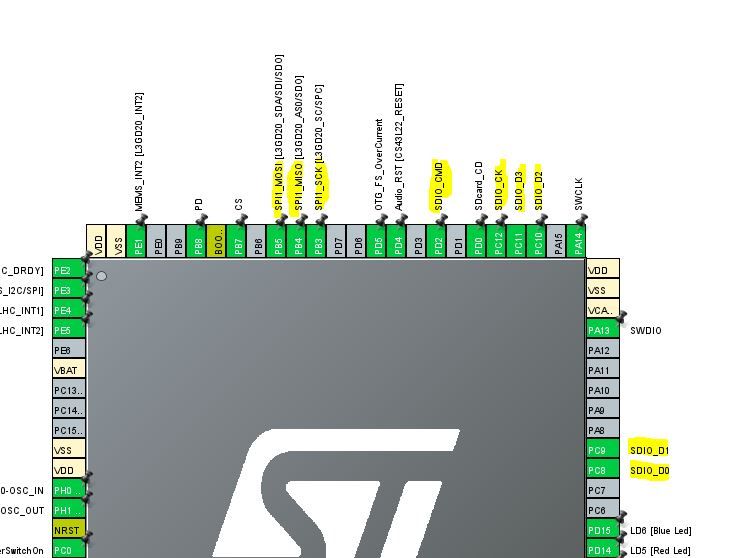

The STM32F411E-DISCO doesn't have a SD Card slot
How is any of this wired up and configured?
Some conflict related to the SPI and Card Detect switch on the card fixture?
Chip selects used?
Trying to run SD Card data transfers concurrently with SPI ones?
Instrument the DISKIO layer, understand what/how the SDIO peripheral is failing, what errors/status it is reporting.
Describe some of the implementational detail.
Review code in that context.

I added the CubeMX pin setting as a photo.
It's not in the picture, but I added SDIO TX and RX as DMA.

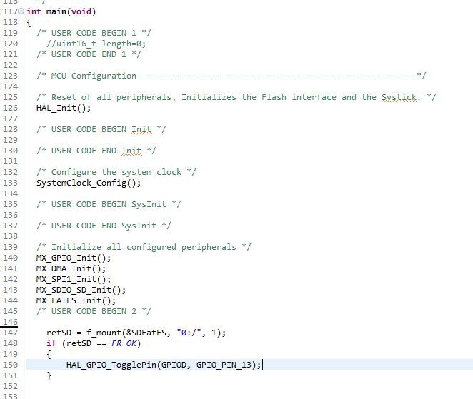

I'll talk about symptoms again.
SPI has been set up, but it is not being used.
Before entering while(), there is a problem initializing f_mount inside the main(). ( in the code, line 147)
F_mount is returning FA_NOT_READY.
I don't think it's a HW problem because using SDIO for other projects works well.
