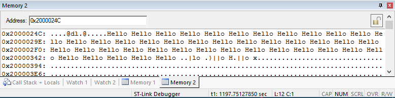

Hi everyone,
I wanted to move a data array(source) to another data array(destination) using USART2 and I wanted to move datas to usart2 and from usart2 by using DMA1. I connect the tx pin to rx pin and it worked. The thing confused me is when I disconnected pins somehow some of the datas were able to go to destination array.
My code is below. Can you explain me what is going on?

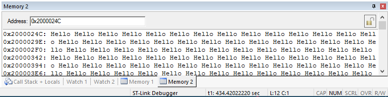

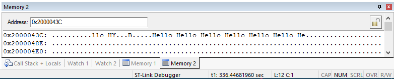

To make it clear.
Usart2 Tx is not connected to USART2 Rx(array size 500)

Posted on March 31, 2017 at 10:19
Try to switch on the pullup on the Rx pin.
mk61
Posted on March 31, 2017 at 10:29
Wow. It worked. What is the difference?
mk61
Posted on March 31, 2017 at 10:36
Thank you very much. I woukdn't guess that.  I was thinkin there is one register for both transmit and recieve  thats why DMA is somehow taking the data it's just wrote.
Thank you again.

Posted on March 31, 2017 at 10:31
You were 'receiving' through some parasitic (capacitive?) coupling between Tx and Rx.
