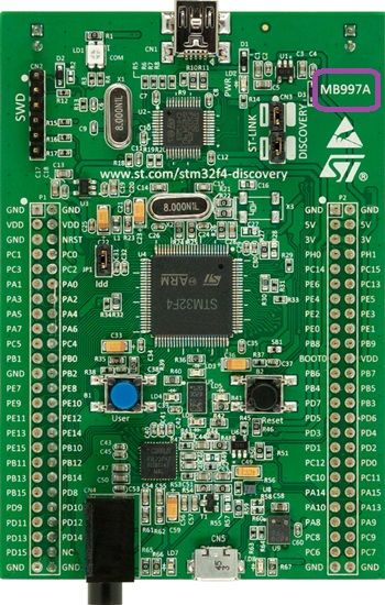

What version of the board do you have? Which accelerometer does it use?
Is this an official ST board, or a clone?

it is probably cloned one because i have bought it from china.
the accelerometer is
LIS3DSH
how to check version of board?
‎2017-05-03 10:28 AM
The colour of the board, buttons, and audio jack should be consistent with this image. The version is in the top corner, the newer boards have ''STM32F407G-DISC1'' silk-screened in the top-left corner, and a board ♯ MB997D
