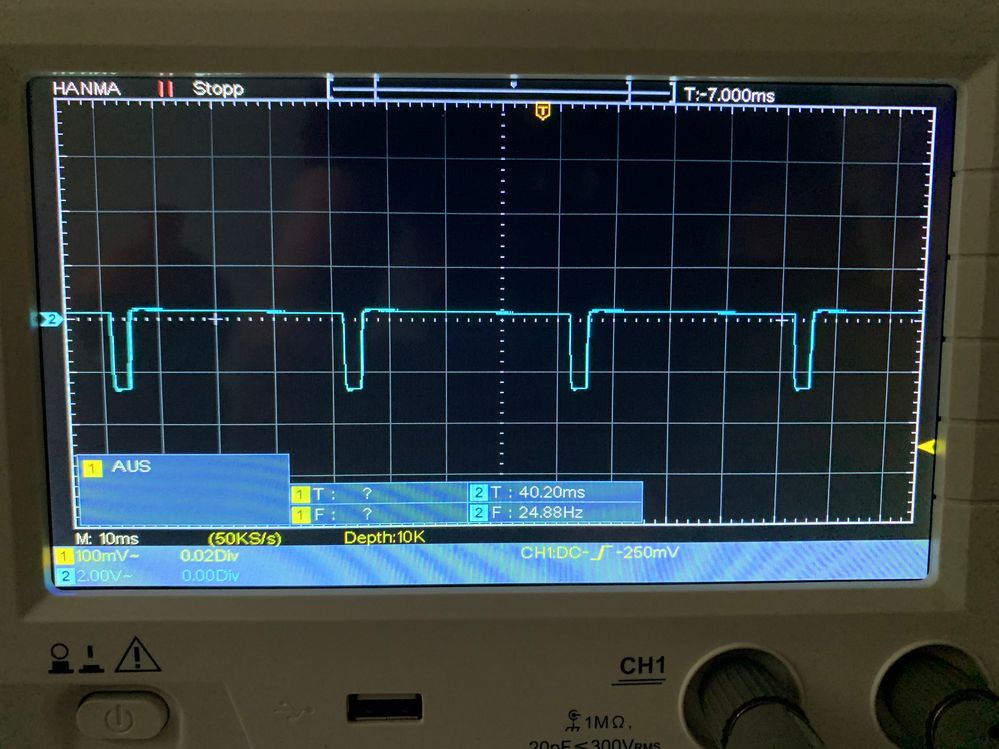

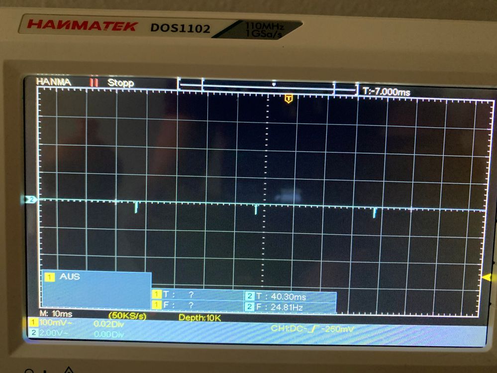

Hi everyone,
I am trying to output DMX data over UART1 at 25Hz. Therefore I need a break for 88us. My plan was to take control over the port and set it into GPIO Mode. After 88us I set it back to UART mode.
For breaktimes > 250us it works fine. But below that value the voltage spike only goes to roundabout 800mV. What am I doing wrong?

Where and how do you measure that voltage? Can you show oscilloscope screenshots for the two different cases?
PUrsu.1
0693W000006FaoLQAS.jpg0693W000006FaoaQAC.jpgHey Jan,
sure! Here are pictures with the delay set to 80us / 3000us.
waclawek.jan
Can't this be just your oscilloscope's limitation?
Do you measure after some optocoupler? If yes, try measuring directly on mcu pin.
