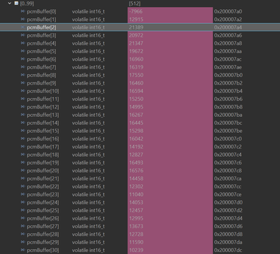

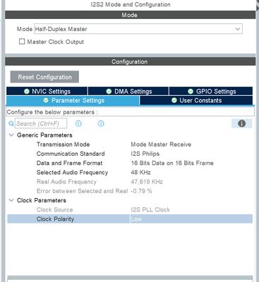

I would like to use the board's built-in microphone to display audio data visualization on an LCD screen. I want to add more display modes later, but at the moment I only have basic waveform time domain display.

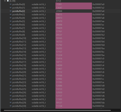

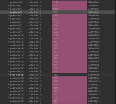

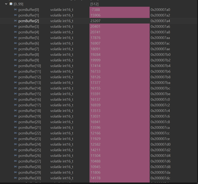

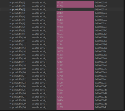

I use the built-in microphone to record audio, which I then convert to PCM using PDM2PCM middleware. However, there seem to be no correlation between the sound and the pcm values. Whether I speak, turn the music on, or do nothing at all - pcm values are about the same.
Moreover, every position in the PCM buffer hovers around the same value. For example, some positions are about ~-11000 no matter what, and the other are about ~20k no matter what. So, the audio visualization is almost flat with some random noise.
I assume that there is something wrong with how I use the mic or pdm2pcm.

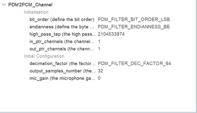

The I2S and middleware settings
Example PCM values
The code
