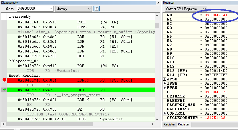

I have a weird problem with one of the boards that I am trying to flash with a custom boot loader.
Consider the following snippet:
Reset_Handler
        LDR     R0, =SystemInit
        BLX     R0
Most people will recognises it as being the first two instructions (in most applications) after loading SP and PC from the vector table.
On one board, the address for R0 is loaded with the address pointing to SystemInit() before it branches indirectly to it:

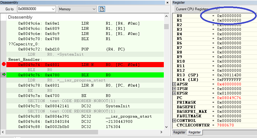

On another board, R0 stays at 0x00000000, and will eventually hard-fault:
I checked the option bytes and micro controller and the two appear to be similar in revision and option byte setting.
Has anyone ever experienced this issue before; and if so, any hints on remedying it?
