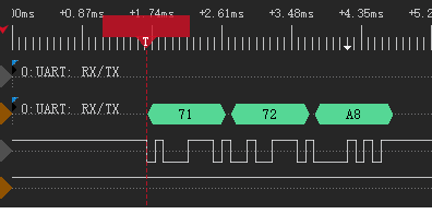

At the Pin RX of STM32F407 , capture the correct data written down by the host as following chart show
0693W000008x1SVQAY.pngBut got the following bytes content in the Rxbuffer
even in the memory location, the data in the DR reg is 0xC8 for the 3rd byte received, not 0xA8 shown at the pin's wave.
Thank you for any thoughts!

jhl14
This LOW LEVEL error is resolved by changing the HSE_VALUE to 8000000HZ。
 #if !defined (HSE_VALUE)
 #define HSE_VALUE  ((uint32_t)8000000) /*!< Value of the External oscillator in Hz(25000000 default value) */
 #endif /* HSE_VALUE */
