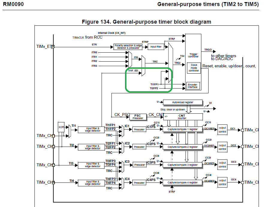

Hi guys,
I am having a big problem; I would like to count external pulses with 2 timers; TIM 2 and TIM5. The problem is, that I need to connect my two timers to the 2 I/O pins that are free. So that means I need to select a channel for each of them. And I just can't find any channel selection for counting external pulses. So I chose TIM2 ch4 on PB11 and TIM5 ch4 on PA3. I need to use 32bit counters. How do I enable any other channel that default channel, which is ch1? Many thanks guys

Posted on August 21, 2013 at 13:56
That'll be a problem as they don't route
  * @param  TIM_TIxExternalCLKSource: Trigger source.
  *          This parameter can be one of the following values:
  *            @arg TIM_TIxExternalCLK1Source_TI1ED: TI1 Edge Detector
  *            @arg TIM_TIxExternalCLK1Source_TI1: Filtered Timer Input 1
  *            @arg TIM_TIxExternalCLK1Source_TI2: Filtered Timer Input 2
Also note Period = N - 1
anze
Posted on August 21, 2013 at 14:50
So that means I can only use ch1? TIM5 ch1 pin is used for user button and TIM2 ch1 is also used for SCL/SPC and for other TIM5 ch1 says it's ETR. Does that means it's external trigger? I tryed and it didn't worked.

I have the same problem. I am not sure I understood ''they don't route''.
How can you see this, what documentation? What datasheet? I need some help it is 2 days I am trying to find a solution.
Posted on April 24, 2014 at 15:49
Well assuming you're using an F407 part, then that would be the Reference Manual, RM0090
The signal routing is limited, you cannot invent connectivity to suit. ''Does not route'' basically means the software/hardware to not provide a method to get from where you are, to where you want to go.
This would be the salient diagram in the Reference Manual, that shows the non ETR/ITR sources for an external clock. This re-enforces the Firmware Library definitions I posted earlier.
