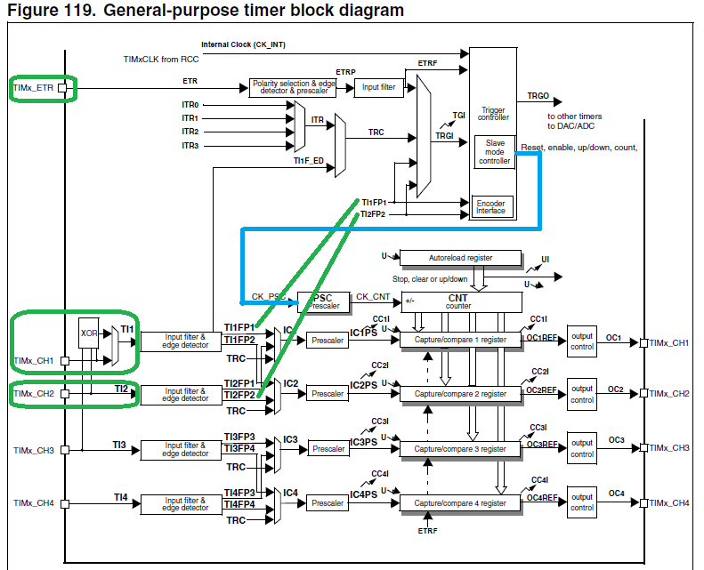

Hi guys,
I am having a big problem; I would like to count external pulses with 2 timers; TIM 2 and TIM5. The problem is, that I need to connect my two timers to the 2 I/O pins that are free. So that means I need to select a channel for each of them. And I just can't find any channel selection for counting external pulses. So I chose TIM2 ch4 on PB11 and TIM5 ch4 on PA3. I need to use 32bit counters. How do I enable any other channel that default channel, which is ch1? Many thanks guys

You can also work out of registers description - here, TIMx_SMCR.
There are 3 possible clock sources:
ECE == 0 and SMS != 111 - internal clock is used
ECE == 1 - external clock mode 2, signal coming from TIMx_ETF pin is used, after being prescaled and filtered, see ETP, ETPS and ETF fields in the same register
ECE == 0 and SMS == 111 - trigger TRGI is used. What is source of TRGI, is given by the TS field in the same register.

Clive1 thank you very much.
I can see it now.
