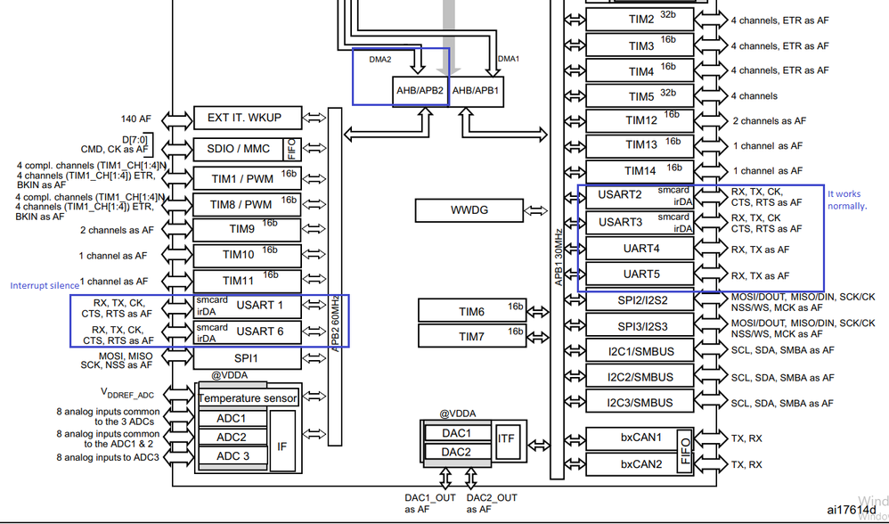

I wish everyone good work.First of all, sorry for my bad english.
I would like to talk about the problem I had with my STM32F407.

When I install applications one by one, all the interrupts in the system work.
But as soon as I install the bootloader and the application, the UART DMA Tx interrupts do not work. A total of 6 UARTs are used in my system.Only UART1 and UART6 where I'm experiencing interrupt silence. UART1 and UART6 work on the APB1 line, depending on the DMA2 channel. I do not have a problem with the working uarts on the DMA1 channel. Although I turned off interrupts during application transitions, I could not solve the problem. I guess something is staying open during the migration.
I checked the addresses of my interrupt vectors. It starts from the same place as the application.
Vector address at application startup = SCB->VTOR = 0x08020100
I'd like to get your opinions on the transition problem I'm experiencing between applications.

Thanks DeLorean,After setting the addresses as 512 bytes, my problem was solved.

Don't the vectors need to live​ on a 512 byte (9-bit) boundaries?
U​se the sector boundaries
