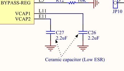

Did you fix the VCAP errors? Going to be hard if you didn't put any traces/pads on those pins. Is the voltage on VCAP ~1.2V?

You need to refer to the STM32F4 hardware getting started AN4488 and refer to the schematics.
From your schematics at least VCAPx capacitors are missing:

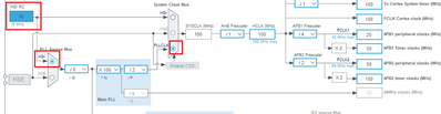

Forget about the crystal for now and try to run with HSI as clock source for system clock:
Do you face the same issue?

Hi Guys, I managed to communicate with the STM via USB and record a hello word on it.
I didn't have access to st link v2 and v3. However, I managed to correct the layout errors on my custom PCB. The crystal oscillator was actually on the wrong pins and the lack of VCAPs prevented the STM from starting. I managed to solder these components to the STM pins and everything worked.
Thank you for your support, I will be more attentive when following youtubers schematic :grinning_face_with_sweat:
