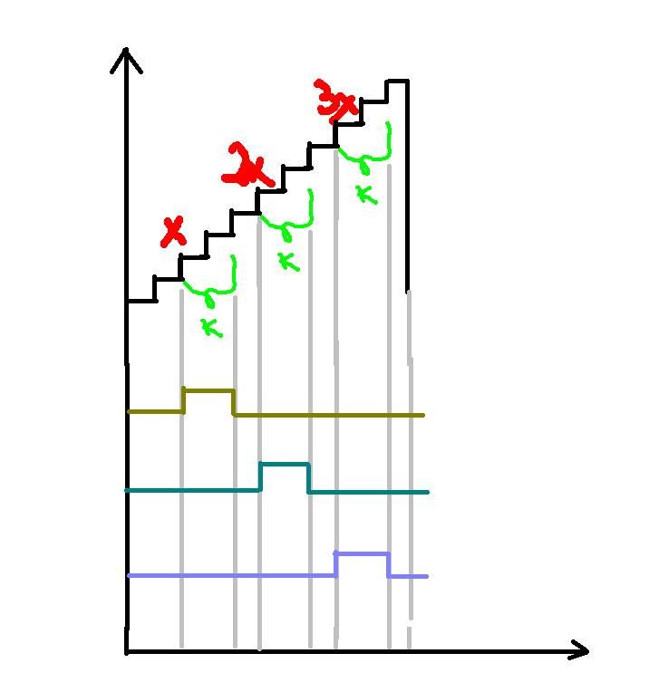

Hi, I want to generate short pulses on channels 1, 2 and 3 of TIM4. Pulses on each channel must be shifted relative to other channels, just like on image below:

Toggle mode has been used to get specific edge placement.
‎2016-11-08 11:34 AM
So all I should do is to set toggle mode at the beginning and in the interrupt handler control only CCRx, right?

I've generally initialized the timer, and initial phase angles, and then advanced the phase angles in the CCRx as each of the prior ones have hit. For higher frequencies one might need to decimate interrupt loading using DMA to load from tables.
I've posted examples of the toggle mode method on the forum, but I'm not a motor guy, and this isn't how I use STM32 parts.Up vote any posts that you find helpful, it shows what's working..
