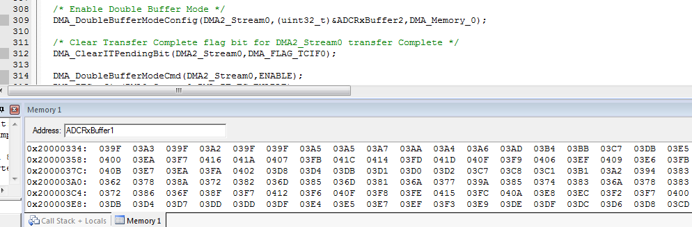

It's incomplete so really hard to do much analysis. I don't think you've got the secondary memory buffer defined properly. Your description of the corruption isn't particularly clear, the way it's explained Sample[0], Sample[2] are good, Sample[1], Sample[3] are bad? Or does it mean the Ping buffer is good, and the Pong buffer is bad? Lacking any example data it's hard to tell.
The debugger does not stop DMA, it might stop a suitably configured timer.
At 8 KHz a sample time of 3 would seem to be very short, and likely given pretty awful readings.

Hi clive,
sample_buffer_ping[0] &[2] is correct, sample_buffer_ping[1] & [3] = 0 and so on...
sample_buffer_pong[0] &[2] is correct, sample_buffer_pong[1] & [3] = 0 and so on...
same behavior is observed for both the buffers...
i used the same DMA double buffer configuration for duplex I2S interface and it was working good.
have increased sample time still no success.
As i am giving sinusoidal signal and correct data [0] & [2] seems to be making sinusoidal signal.
Each buffer size is 1024, and it is taking 128ms for each buffer to fill completely which is correct for 8kHz sampling time.
example data :
buffer1 = {2722, 0, 2162, 0, 1535, 0, 1226, 0, 1453, 0, 2049, 0, 2647, 0, 2869, 0, 2576, 0, 1962, 0, 1400, 0, 1240, 0, 1610,.....}
buffer 2 = {1242, 0, 1380, 0, 1933, 0, 2571, 0, 2865, 0, 2656, 0, 2049, 0, 1458, 0, 1231, 0, 1526, 0, 2125, 0, 2707, 0, 2868,.....}

Again completeness seems to allude us, please refer to the examples I post to understand what I'm asking for. It means the solution must be free standing, and compilable.
Based on the description, I'm going to guess you're not reading the right values via DMA, and whatever you've define ADC3_DR_ADDRESS is incorrect.
Change :
DMA_InitStructure.DMA_PeripheralBaseAddr = (uint32_t)ADC3_DR_ADDRESS;
to
DMA_InitStructure.DMA_PeripheralBaseAddr = (uint32_t)&ADC3->DR;

usama
Posted on March 28, 2014 at 10:21
Hi clive,
Thanks for your response, i have posted compilable version of complete code. kindly have a look.
Change :
to
also not solved the problem,
ADC3_DR_ADDRESS = 0x4001224C which is the actual address of ADC3 data register.
Posted on March 28, 2014 at 17:14
Seems to work fine for me, what are you debugging with? CooCox?
usama
Posted on March 29, 2014 at 12:31
Thanks alot clive for your support, my problem is solved now. I was indeed debugging with coocox. Problem was a ridiculous mistake on my end. Now i am able to make ADC & DAC to work at 8kHz with double buffer DMA at both ends. Thanks again.
