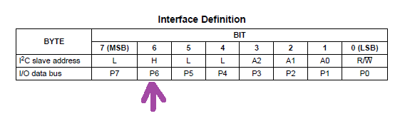

I'd wager you need to be using the address 0x40 not 0x20, the 7-bit addressing complicates things because some systems shift the address, whilst some do not. The ST implementation passes through the address and masks/sets the low order bit.
kenny__84
Posted on June 29, 2013 at 15:11
Clive1 that's absolutely awesome!!
I am so happy that this is working now!
So maybe a dumb question but how do you calculate this?
address 0x20 becomes 0x40 but how?
