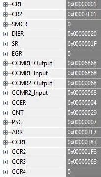

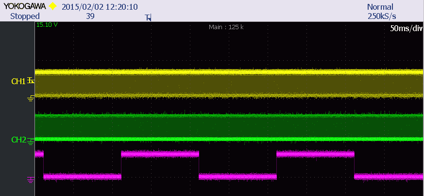

In the following picture, channel 1 and 2 are CH1 and CH1x respectively, and channel 3 is the pulses generated by GPIO_ToggleBits(GPIOD, GPIO_Pin_12) I added before the switch command.

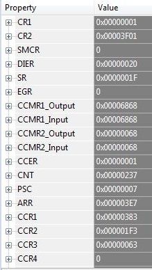

I attached some pictures to show the register values, and you can see the register changed accordingly, but the output of CH1 and CH1x didn't change at all.

CCER = 0x4
after
TIM_CCxCmd(TIM1, TIM_Channel_1, TIM_CCx_Enable);
TIM_CCxNCmd(TIM1, TIM_Channel_1, TIM_CCxN_Disable);
CCER = 0x1;

I asked you for *all* TIM1 registers' content. TIM1 (and TIM8) has more registers than other timers.
> CR2 == 0x3F01
Do you understand the implications of this, especially  the CCPC bit being set?

Thank you so much for pointing out CCPC. I should have read the manual more carefully. Now everything works fine. Thank you very very much.
