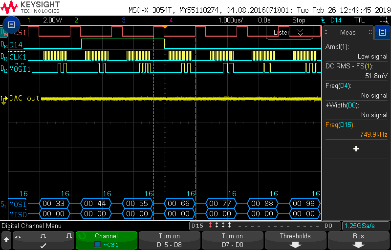

Need to generate a repeating waveform with external SPI 16-bit DAC.
Using a table of values in memory, repeatedly loop through table outputting values to DAC.
Delay between outputs is constant. No glitches at repeat!
DMA only (no interrupts).
What's the most effective way to do this with ST32F427?
Thanks,
Best Regards, Dave
    Best answer by Dave Nadler
    This turns out to be much easier than I thought (I missed 'DMA circular mode' first go around).
    One timer to:
    • trigger DMA on overflow (sets update frequency)
    • generate CS signal of correct length to bracket SPI transfer (unbelievably, lame STM32F SPI module fails to do this correctly)
    DMA:
    • output from sample array in memory to SPIx->DR
    • run in circular mode (NDTR is number of samples in waveform table)
    • 16-bit transfers for this DAC
    • triggered by above timer; each timer trigger does 1 transfer (not NDTR transfers as manual might lead you to believe)
    Scope picture below (top trace is CS, bottom 2 traces are SPI clock and MOSI):

    Dave NadlerAuthorBest answer
    Senior III
    February 26, 2019
    One timer to:
    DMA:
