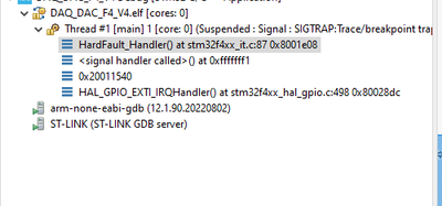

I use stm32f4 micro but an external interrupt pin
when i increase frequency of the external signal connected to interrupt pin, the micro jump to hardfault
why? how I can detect the solution?

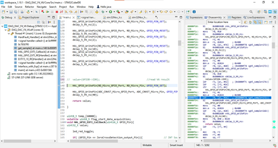

char received_string_data[4];
Look at this https://www.tutorialspoint.com/c_standard_library/c_function_strncpy.htm
Your destination array size is less.
>how i can found it?
A good question, thank you ))
The compiler should give a warning :  warning: 'strncpy' writing 12 bytes into a region of size 4 overflows the destination [-Wstringop-overflow=]
But I've tested with several gcc versions on godbolt and was surprised that this warning shows up only starting with gcc v.12.something. Not in 11 and below, even with explicit -Wstringop-overflow option.
So ... Update to the latest gcc. If you cannot do this, use 3rd party tools for code analysis (which may be even better and robust).

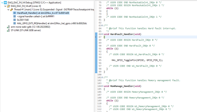

i remove an 60000 byte array
why compiler does not warn or error when we use huge array in local functions?
Neither the compiler or linker track call-stacks and stack usage, most of this occurs dynamically as the code runs, not a static allocation which the linker must fulfill.
You should not have more local/auto variables that exceed the available RAM under the stack pointer.
The received_string_data variable is global in that code, but that doesn't change the fact that the code writes beyond that buffer.

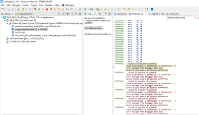

the program hard fault ....
how I can solve ?

Everyone explained to you what is wrong with your array. Think of it this way, you have a tennis ball container (array)  that can only hold 3 tennis balls (values), max. You're basically trying to fit 4 or more balls into a container. So when you try to fit 4 balls in a container, all it's going to do is burst (hard fault).
So in your instance you're trying to put 5 or more values into an array that can fit only 4 values. Get the idea what's wrong now?
