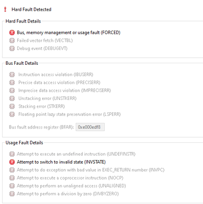

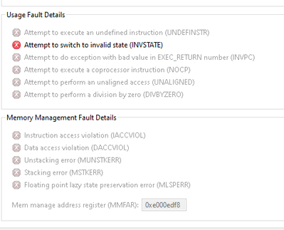

most of the time my code faults in EXT Interrupt
but i can not check which section trig this section.
this is the fault analyzer.

In the stack trace 20011540 is a RAM address. How you've got there? This looks like stack corruption (overwrite).
jhasa.2
why the stack is corrupted?
is it related to fake micro-controller?
