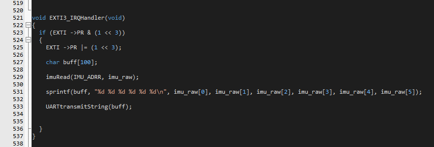

I'm using an stm32f411ce with an lsm6ds3 IMU and I want to trigger a read from the IMU with an EXTI. I've set it all in the code below and activated the interrupt on the IMU. the interrupt is set in PR register but handler is never called.
Thanks,
Eyal

that is the handler implementation.
0693W00000FChi0QAD.pngdoes it seem fine?

C++?
not sure what you mean but I am using C++
So it has C++ linkage, not C linkage, which means the linker doesn't see it as EXTI3_IRQHandler.
To fix, surround it in extern "C" braces.
extern "C" {
void EXTI3_IRQHandler() {
OK thanks.
the whole main file is cpp. does it still matter?
It works now! thank you very much
I'm not sure what you're asking, does what still matter?
Generally, that's the main gotcha. If you have other IRQ handlers in there, or functions that are called from C source files, those also need to have extern "C".
ok now I get it thanks!
