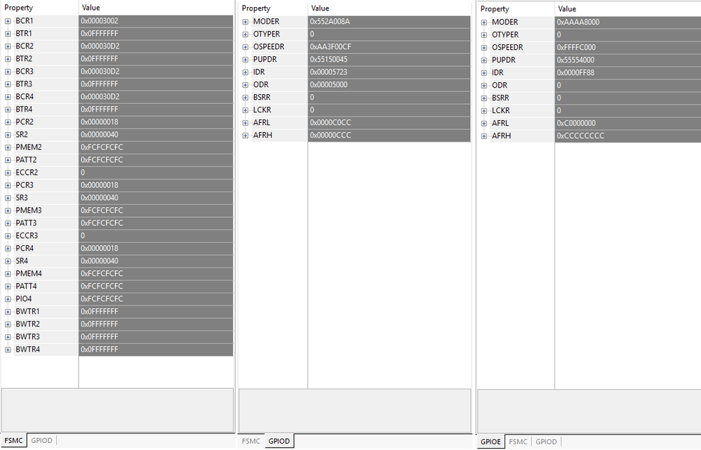

Posted on January 13, 2016 at 22:12
It's not a device yet. I'm just trying to correct the clock signal and it's frequency with osciloscope. But I'll use it with a system it's not a memory device which has 16-bit data, clock and latch input. I think I must use synchronous communication. I need to go up 40MHz (+/-  10MHz). I'm at home now I'm going to send register contents tomorrow morning.
Posted on January 14, 2016 at 15:00
Here is the FSMC, GPIOD and GPIOE registers and their contents.
waclawek.jan
Posted on January 14, 2016 at 16:40
While I wrote ''post register content'', I meant ''look at the registers content and think yourself'' :)
FSMC_BTR1 is uninitialized.
I don't ''speak'' SPL nor Cube, but I suspect what you did is not the proper way how the FSMC should be initialized.
Posted on January 14, 2016 at 17:42
Thanks again Jack. Can you give some advice that how to properly initialize the fsmc?
Posted on January 16, 2016 at 10:55
I've wrote the settings without SPL now I can get clk signal in acceptable voltage range. But this time waveform is not square wave probably oscilloscope has some issues.
