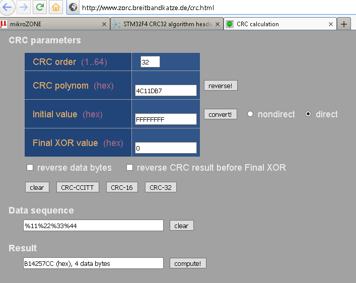

Besides Clive's program, the srecord package embeds also a STM32 CRC calculation (arguably it's not the easiest to use though). This is my favourite CRC online calculator http://www.zorc.breitbandkatze.de/crc.html with Clive's data (note the tickboxes' settings):
and your data:
One way how to check if your CRC calculation is not completely failed is to append the result to the checksummed data and perform the CRC again; the result should be 0 - this is what Clive did in hist last example.
