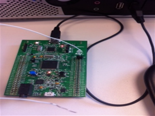

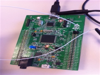

I'm connecting stm32f4-disco through USB to the computer and I'm measuring the 5v output pin from the board with a scope and I get 3,9 V. Did I burn it or something? Thank you- Mark as New

Oh, output of USB is below 5V and is just 3.9V?
i figure GPIO output 3 possible scenarios: 1) Long usb cable, usually can give 4.6V even if small amount of current is used 2) i think this board has diode in series with usb, it is D2 BAT60JFILM diode, measure voltage drop on this part, anyway, it will be around 0.6V even at small load, so you will get only 4.4V on 5V pin 3) you have short circuit and it draws more than 500mA- Mark as New
‎2015-07-20 9:32 AM
Thank you for reply.
The usb cable is short, like in the picture. I think that the diode in serie with USB is D1. I get 5V on one side of the diode and 3,9V on the other side. I think this should be something like 5V and 4,7V.- Mark as New
‎2015-07-20 10:50 AM
Just solder 0 ohm resistor. If you are not going to put any voltage to dev kit to 5V rail, it is not very useful. This is what i did, sine stm32f429i-disco with screen was getting low on voltage, after that it worked just fine :)
