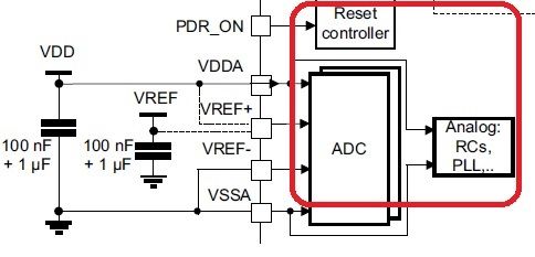

VDDA starts after VDD
‎2015-07-20 2:02 AM
In the
http://www.st.com/web/en/resource/technical/document/application_note/DM00115714.pdf
is written: ...During the startup phase VDDA must arrive first and be greater than or equal to VDD.
... Why that what if it is not so? Is it possible to start first VDD before VDDA? If yes, under which conditions?- Mark as New
‎2015-07-20 5:55 AM
I can't find your quote with a search of this reference. Please provide section number and paragraph.
In the F405 data sheet, the following information provides guidance. Check the data sheet for your processor of interest. ''It is recommended to power VDD and VDDA from the same source. A maximum difference of 300 mV between VDD and VDDA can be tolerated during power-up and power-down operation.'' Cheers, Hal- Mark as New
‎2015-07-20 8:20 AM
Sorry, AN4080, Page 6:
... The VDDA voltage level must always be greater than or equal to the VDD voltage level and must be provided first. ... What about startup/power on in this case? To the previous questions, one more: Now after the knowledge from AN4080. What will happen if VDDA fall down and VDD is OK.- Mark as New
‎2015-07-20 8:43 AM
If it thresholds the POR, then the NRST is going to be clamped low for a period as described in the manual. The manual and not the App Note is the controlling documentation.
If you can't control the VDD/VDDA with respect to each other, then I'd suggest you threshold both with external POR circuits that clamp NRST low for a 100ms or so, that way both attain stable operating levels before the processor, and code execution, is permitted to start.Up vote any posts that you find helpful, it shows what's working..
‎2015-07-20 8:49 AM
That same page 6 lists the functionality that will be lost. Don't know if anything will be damaged. ST's guidance is to use the same source for Vdd and Vdda, and add additional filtering to Vdda to reduce ADC and DAC conversion noise. If you are doing something different, I suspect you may be on your own. Cheers, Hal- Mark as New
‎2015-07-20 9:11 AM
...Don't know if anything will be damaged....
That is my question. I have an LDO on VDDA. Theoretically it can: start later than VDD can fall down anytime- Mark as New
‎2015-07-20 9:21 AM
Going to cause the VCO/PLL/HSE/HSI to FAIL, or become unstable, and if it gets sufficient low the processor will be held in reset.
I don't expect gray smoke, but you will get undesirable operation...Up vote any posts that you find helpful, it shows what's working..
‎2015-07-20 9:27 AM
>>Going to cause the VCO/PLL/HSE/HSI to FAIL.
Does it mean that I can't trust an internal watchdog in that case and I have to solve it external on the board?- Mark as New
‎2015-07-20 9:57 AM
For STM32F415...(data sheet STM32F415xx STM32F417xx) I could not find the time constraint, mentioned above. Do I need to take care about the time constraint on STM32F415?
Only a following restriction: It is recommended to power VDD and VDDA from the same source. A maximum difference of 300 mV between VDD and VDDA can be tolerated during power-up and power-down operation.- Mark as New
‎2015-07-20 10:04 AM
Well you're entering a whole domain of unknown/unspecifed behaviour.
