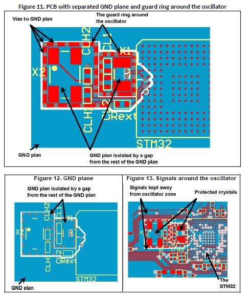

Posted on January 30, 2017 at 03:37
I think it should not route any signal under clock/X'tal line.
It disturbs X'tal oscillation stability.
For more detail,see Oscillator design guide.
http://www.st.com/resource/ja/application_note/cd00221665.pdf
Posted on January 30, 2017 at 11:19
Thanks for pointing it out. I must pay a bit more closer attention, while doing the PCB. It's a pain to move around the traces from the PORT P4. Fortunately, the HSI seems to be working now. It appeared to be an issue with the code that the device was not working with the HSI Internal oscillator.
