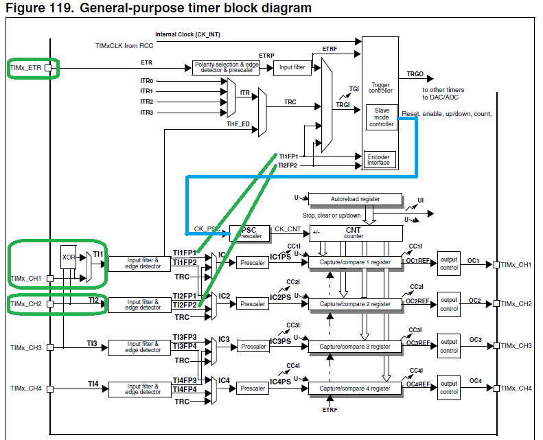

Hi
I would like to
know
if is possible set
a timer
or other peripheral on the STM32F30x
to count
up or down
the pulses applied
to a pin
depending on the
logic level
applied
to a second
input
. For example if the second input is high the pulse are counted Up instead if the second input is low the pulse are counted Down.

OK. Configure the timer as a counter, clocked by the external input, the IP to be counted.
The second input, using IRQ so needs to be a EXTI IO. The IRQ should edge triggered (will have to look up to see if this is possible). On IRQ, the ISR checks the level and changes the timer count direction.

Clive1 many thanks for your suggestion but as per reference manual (page 480) in
TIM_EncoderMode_TI1
mode if the signal on the second (opposite) input don't change the counter go up and down (or down and up) on each rising and falling edge of the first signal (main signal). Instead I need that the counter count only on one edge (rising or falling) in the direction specified from the second input. Do you think that is possible? Thanks.

The Up/Down on one signal versus the clock edge of the other sounds exactly like
http://www.edn.com/design/integrated-circuit-design/4363949/Decode-a-quadrature-encoder-in-software
. I haven't looked at the F3 docs thoroughly, but the F4 suggests it can clock on the edge of one signal, instead of the edges of both, if configured correctly, and you can pick which.
To understand relative phase, then perhaps input capture of both edges, in different channels, and then interrupting on the trailing one, and either measuring the periodicity or phase relationship based on current and prior values.

Dear Clive1,
thanks for your suggestion. I have try the code that you link in the previous post and I have found the following problem:
1) The RM0316 documentation regarding SMS slave Mode Selection say: ''0001: Encoder mode 1 - Counter counts up/down on TI2FP2 edge depending on TI1FP1
level.''. Instead I found the counter change on the TI1FP1 edge and not TI2FP2.
2) If the clock input is low after timer initialization the counter count down on the falling edge instead if the clock input is high after timer initialization the counter count up on the rising edge of the clock input. Please note that this happen with the second (direction) signal stable.
I think the point 1 is a simple typo error but the point 2 behavior is a big problem because after power on I need to be sure about the count direction and active edge regardless to the clock signal level at power on.
Any idea? There is somewhere a detailed view of the Slave Mode Conrtoller to better understand the logic?
Thanks.
Posted on March 21, 2014 at 17:02
#1 Yes RM0090 is like that too, the library code defines it the other way around, which I think is correct.
#2 I'm not sure what you're going to do about initial conditions, if the external states don't match the internal ones there will be a perceived edge/transition. You can swap the pin designations in hardware or software. The signal is not directly connected to the pin, it goes through a synchronizer and a filter/edge detector.
