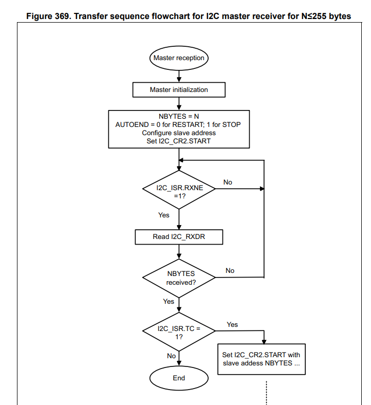

Im using STM32F302R8 and developing the driver for I2CMasterReceive data from Arduino.
Here is my problem:

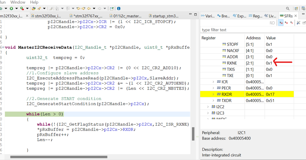

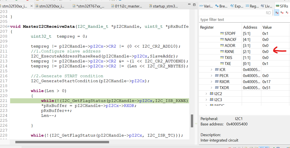

_legacyfs_online_stmicro_images_0693W00000biAUCQA2.pngAfter I send a command code, from master 0x51, and generate the start condition, the RXNE is SET.
But, after it goes into the while loop, the RXNE suddenly RESET. I do not read yet the RXDR register.
I do not know why this problem happen. Could anyone help me?
