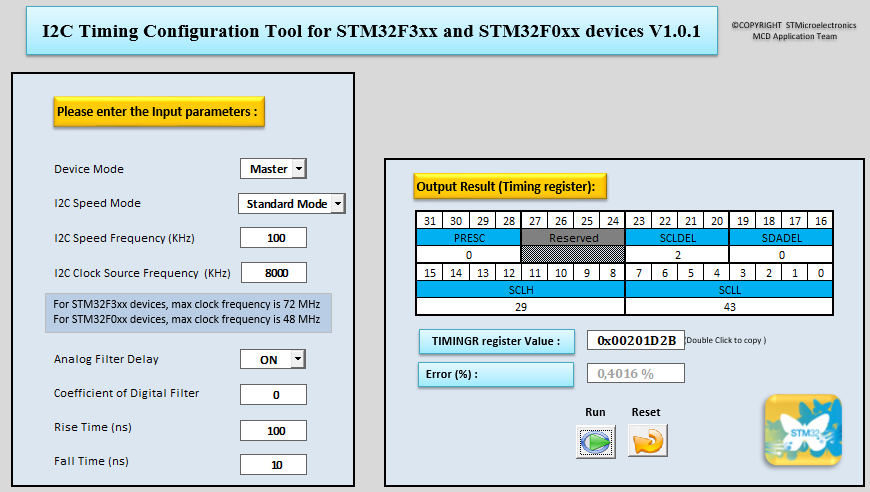

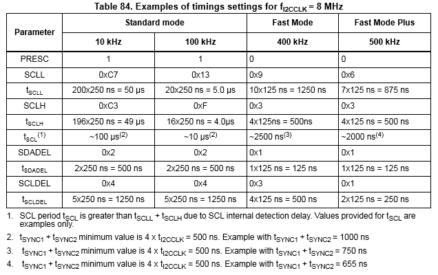

Hi, i am using STM32F303VC MCU, in particular i'm working on an I2C application.
I am using STM32F3 series reference manual (RM0316) and I2C_Timing_Configuration_V1.0.1.xls to generate correct timing settings.
My question is: Which input parameters should i insert into I2C_Timing_Configuration_V1.0.1.xls  to obtain the value 0x10420F13 that corresponds to the first example (100 kHz column) of I2Cx_TIMINGR setting on reference manual?
Thanks in advance.
