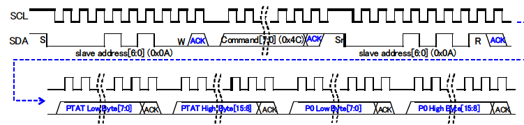

The protocol is shown in the image above. How can i generate a re-start condition. i have tried
Hi i have e following code for communication with an I2C Device.

// NEED TO GENERATE RESTART CONDITION HERE
I2C_GenerateSTART(DEVICE_I2C, ENABLE);
while(I2C_GetFlagStatus(I2C1,I2C_FLAG_BUSY));

but it still when into the timeout. Thanks.
