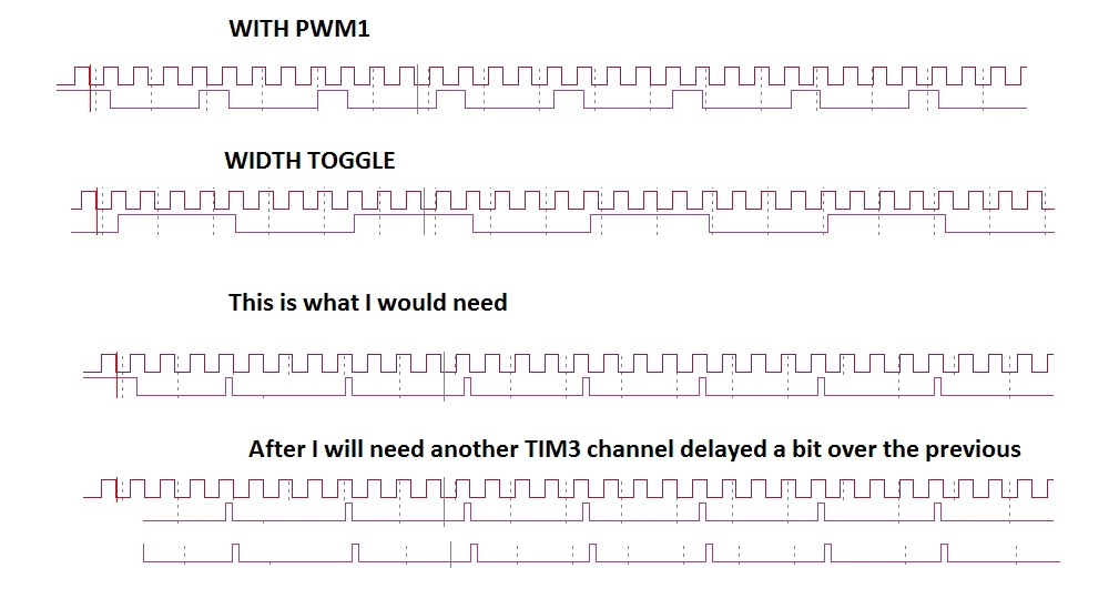

Hi.
To start i'm using STM32F207
I have a 15Mhz signal (that sometimes is enabled and sometimes it is not) connected to TIM3 ETR. I just want to count pulses and generate a pulse after few of this clocks (from 1 to 16 configured by software).
To try it, I have set the TIM3 ETR (PD2 pin) as clock for TIMER 3, and it works (it starts counting). The code used is:

This is working ok as I said. Now I want to make a pulse faster than TIM3 clock if possible. Configuring TIM3 to count up from 0 to the current count limit

And now I have to set the output. I would like a pulse, so i tried the One-Pulse thing, but it is not working or not working as I wished. I have tried with PWM1/2 and Toggle. It counts right, but toggle is not ok since it generates a ''clock divider'', and pwm generates pulses at speed of the clock and thats not ok.
I would need a small delay between the detection of the counting event and the rising of the output. This is what i tried:

In the image attached I explain what to I get and what do I need.

Given you want a smaller pulse width than the input clock, you're going to have use a master/slave relationship using TIM3 to trigger a one-shot mode on a different timer clocking at a higher rate (system).

Sync timers sounds good, I suppose that tim3 is slave, the new timer is master, setting the new timer to the faster speed possible as you said would be ok, but then, but then i see the same problem again... you have a counter and you want a pulse...
I suppose that you need to make a PWM in the new timer (the only way to make a real pulse based in channels configuration).
