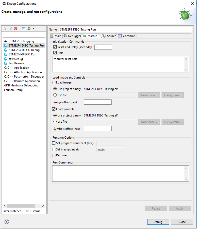

Thanks, but after this I still have the same error. I removed all breakpoints and removed the initial default breakpoint. Also, I've attached mystartup settings in my debug configuration.
In addition, when I debug this configuration here is the console output:

Edit: I'd also like to point out that when I build then just run, not debug, the st link programs the processor fine and then the program runs fine, and I can blink an LED on a timer fine, but I still cannot connect via putty. This leads me to believe there is some kind of driver issue with the st vcp driver. Has anyone else had this issue?
Posted on January 06, 2018 at 17:23
The target is halted due to startup reset, which should be fine. I prefer not to enable 'Reset and Delay', 'Halt' nor 'Resume', but I'm not entirely sure of their relevance.
In your code I noticed the lack of SET_LINE_CODING and GET_LINE_CODING implementation, I would try it with the original template code, maybe this causes the VCP connection issue:
