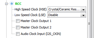

I'm using the STM32F401RE Nucleo board, I have noticed that the internal clock HSI has a quite high inaccuracy over temperature and it's not suitable for my application.
I want to use an external clock for the board but I don't know how to properly install and configure the external clock?
And in STM32Cubemx, when selecting SMT32F401RE Nucleo board, in 'Clock Configuration' tab, it's not possible for choosing the HSE clock, only HSI clock available.
Any example on how to use external clock source would be great for me.
Thanks

Hi
le.bien
,STM32Cubemx, when selecting SMT32F401RE Nucleo board, in ''
Clock Configuration'' tab, it's not possible for choosing the HSE clock, only HSI clock available.
You have first to enable RCC in Pinout tab :
Please refer to OSC clock paragraph on
for more details about the way to configure the pins corresponding to external high-speed clock (HSE) on Nucleo board.-Nesrine-

‎2017-02-06 4:12 AM
Doesn't the Nucleo have 8 MHz present on the pin from the ST-LINK? Should select HSE BYPASS mode.
