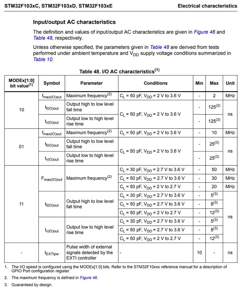

STM32F103RDT6 UART rise and fall time
Mom.1
Could anyone please share the rise and fall time of UART transmission in STMF103RDT6. Those data I cant get from the datasheet.
Kindly reply.
Warm regards,
Monisha OM
1 REPLY 1
STM32F103RDT6 Data Sheet https://www.st.com/resource/en/datasheet/cd00191185.pdf
Depends on the loading, and depends on the slew rate (speed) selection on the GPIO configuration
