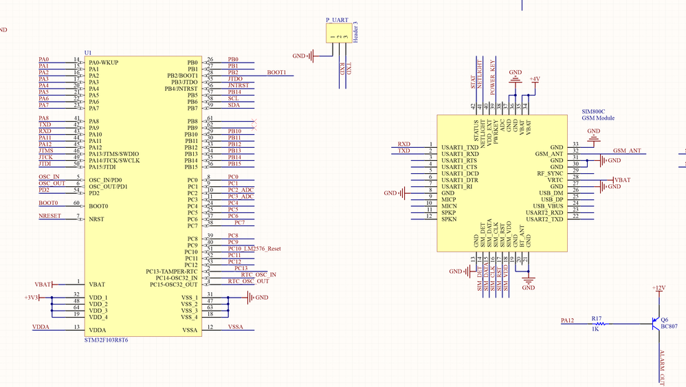

I'm trying to use LL drivers for STM32F103 series using CubeMX and my problem is that when i try to send a byte LL_USART_TransmitData8(USART1, data) the USART Transmission Complete Flag is never set and no data is transmitted through .
I should say that when i switch to HAL everything works perfectly fine and both sending and receiving data is working fine.
any help is greatly appreciated

as you can see the board set up and the .IOC file are both simple, i also tested the board using the given examples in stm32cube folder and still no data is transmitted .0690X000006CLpQQAW.png

the code generated by CubeMX is included as well as the function that is supposed to send the data,
thanks in advance for the help
