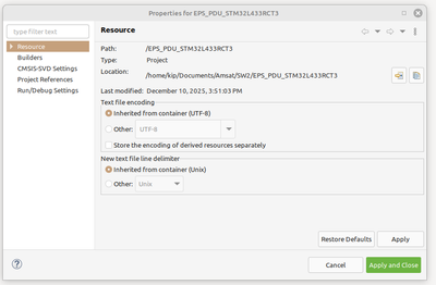

I did see a warning on the project name in the Project Explorer
Description Resource Path Location Type
Project 'EPS_PDU_STM32L433RCT3' has no explicit encoding set EPS_PDU_STM32L433RCT3 /EPS_PDU_STM32L433RCT3 No explicit project encoding
I do not know what that means. I do not think I changed anything.
Is that encoding right for Linux?
It looks like it inherited UTF-8 from linux. Other is UTF-8 what is wrong?
Is this causing my issue?

Hello @kmoravec
Could you check if the firmware is installed? If not, you should go to Help> Manage embedded software packages and install the missing firmware.
KR, Souhaib
