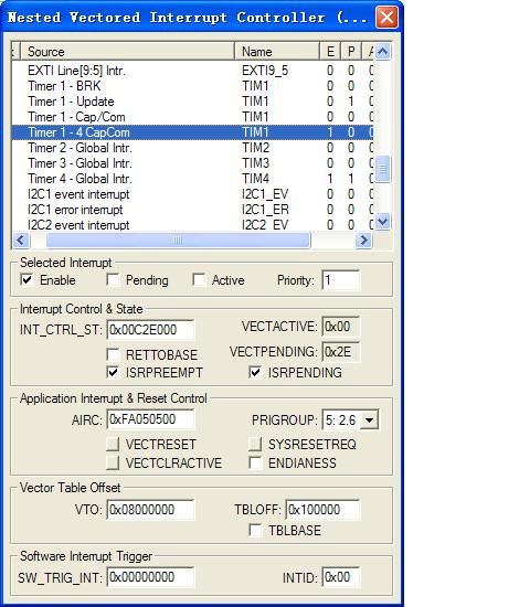

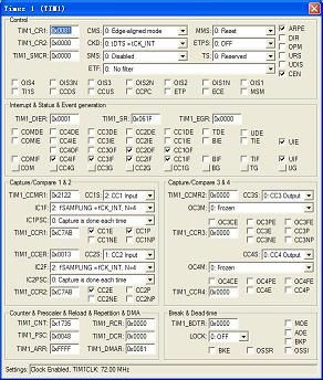

but the can not enter the TIM1 cc1 intterupt isr.
i check the NVIC. the

Observations :
     TIM_TimeBaseStructure.TIM_Prescaler = 72;
This needs to be 71 (ie N-1) to do what you want. ie get 1 MHz from 72 MHz
    RCC_APB2PeriphClockCmd(RCC_APB2Periph_TIM1||RCC_APB2Periph_GPIOA, ENABLE);
You keep using '||' throughout your code, where the single '|' OR is supposed to be used.
